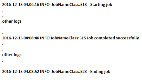

Hi,
I have batch job logs that look like below,
My output needs to look like this,
The challenge is that the job may fail, in which case it is rerun by another team.
So, in case of job failure, the table should have an entry for success run and one for failure run.
Please help me form the search .
Thanks in advance!!

Assuming your data is indexed in splunk, try this
index=foo sourcetype=bar ("Starting job" OR "completed successfully" OR "job ended") | rex "JobNameClass:\s?(?<jobclass>\d+)" | rex "(?<completed>Starting|completed|Ending)" | transaction jobclass startswith="Starting Job" endswith="Ending Job" maxevents=3 mvlist=t keepevicted=t | eval endtime=if(mvcount(status)=3, strftime(_time+duration, "%H:%M:%S"), null()) | eval startdate=strftime(_time, "%m/%d/%Y") | eval starttime=strftime(_time, "%H:%M:%S") | eval jobstatus=if(mvcount(status)=3, "Completed", "Failed") | table startdate starttime endtime duration jobstatus

Can you provide the sample event for condition when the job fails?
