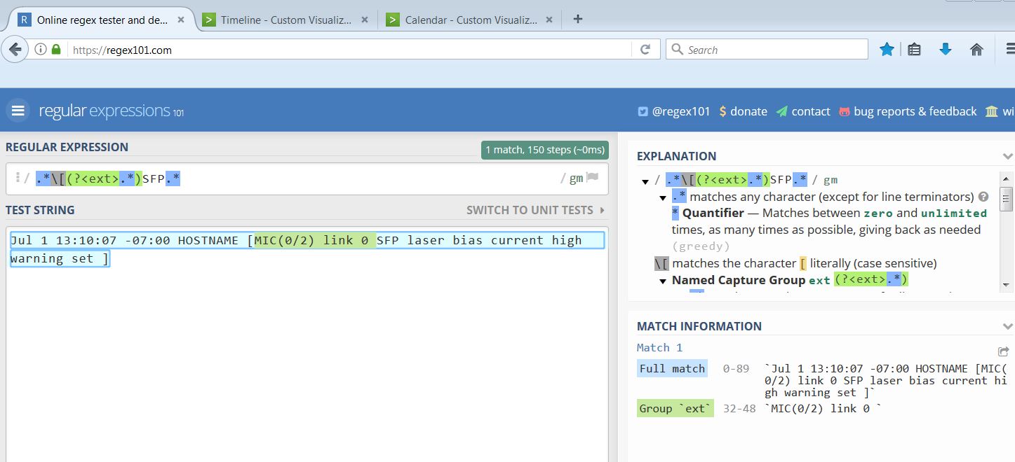

Something like .*\[(?<ext>.*)SFP.* -

Also, I recommend that you play around with your regexes on regex101.com
