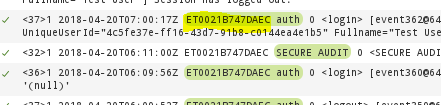

I want to create a field which extract values, however I have some field values that I want to extract which contain more than one word.
For instance:
alt text (image file: field-error.png)
I want the 'auth' and 'SECURE AUDIT' values to be considered as part of the same field that I am going to create. However I got the field extraction error message: "The extraction failed. If you are extracting multiple fields, try removing one or more fields. Start with extractions that are embedded within longer text strings."
Basically I want to extract the text between the yellow boxed text and the value '0' to be added as a field.
How can I add the field such that I don't get the error?
Splunk only highlighted the first word 'SECURE' instead of 'SECURE AUDIT', which is not what I want.
Output with the following regex suggested:
(?:[^\s]+\s){2}(?P[^\s]+(?:\s\w+)?)\s\d+\s+<
alt text (image file: error-3.png)
I tried to modify the regex by removing the 'w', and it highlighted only the 'auth' texts and 'AUDIT' without the 'SECURE'
To display the result output I have removed my second image as Splunk only allows two image files uploaded.
Regular expression generated by Splunk:
^(?:[^ \n]* ){3}(?P\w+\s+\w+)
I realized the regex suggested by one user extracted wrongly as he/she did not include < 37 > 1 at the front of the lines as indicated in my text line. The wording got misaligned and hence the wrong extraction.
https://regex101.com/r/biHi9a/4
The link above is the correct sample text that I want to work with. Would appreciate any help to modify it to achieve my desired results.

Go to http://regex101.com and build it yourself. You should not be using Splunk's regex builder.
cafissimo
Communicator
Here it is a working complete example with the extraction of "field1"
| makeresults count=2
| streamstats count
| eval _raw=case(count==1,"<37> 1 2018-04-23T08:08:08Z E876876876 SECURE AUDIT 0 <secure audit error> [cdkncdckne dckmdkcmd]",count==2,"<37> 1 2018-04-23T08:08:08Z E876876876 auth 0 <login> [kdnckn rrgrr]
<37> 1 2018-04-23T08:08:08Z E876876876 auth 0 <login> [kdnckn rrgrr]")
| rex field=_raw "<\d+>\s+\d+\s+(?:[^\s]+\s){2}(?P<field1>[^\s]+(?:\s+\w+)*)\s\d+\s+<"

Try this regex:
Test it here:
https://regex101.com/r/biHi9a/1
Best regards
gilbxrtx_7
New Member
Hi, your answer seems correct in the regex test link. However when I copied and paste the exact regex into splunk, it somehow highlighted the text wrongly.
It highlighted the text before the auth as part of the field extraction as well.
I have edited my question to display the output when I added the regex you suggested into splunk.
@cafissimo
I realized that your regex sampled worked because you did not include < 37 > 1 at the front of each line. After I added < 37 > 1 the alignment shifted and the text were not highlighted correctly anymore
I have attached the updated link with the correct sample text

FrankVl
Ultra Champion
Can you share the regular expression that Splunk generates for you? Then we can help adjust it to achieve your desired result.
gilbxrtx_7
New Member
This is the regular expression generated by Splunk which extracted wrongly.
