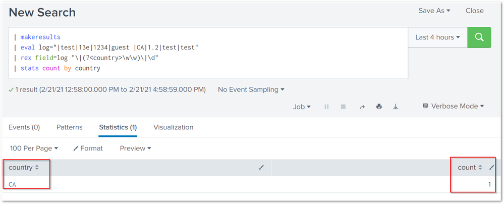

inventsekar
Hi @Linnie25
If the fields are not extracted, then, you have to use rex to find out the country and then count.
| makeresults
| eval log="|test|13e|1234|guest |CA|1.2|test|test"
| rex field=log "\|(?<country>\w\w)\|\d"
| stats count by country
