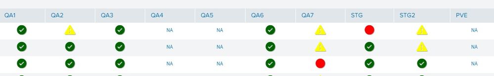

I'm somewhat new to Splunk.
I have a dashboard displaying a table with data. I have code that fills in the columns with 4 different values.
For example, the NA values underneath the column(ex QA4, QA5, PVE) should cause the whole row to have a red outline in the corresponding boxes.
The green checkmark comes from a DB and the value that causes that is "low", yellow icon is "moderate", and the red circle is caused by a "severe" value from the table. How can I get the "NA" to change the whole row to a red outline?
With CSS/Javascript?

@bmendez0428 please use the following run anywhere example on similar lines as per your question. It gets the ERROR, INFO and WARN log levels for Splunk's _internal logs and converts the range of count of each over time to SLAs i.e. low, moderate and severe. Whenever any row has a column with NA, it adds a red border to the same.
PS: I have extended the DARK mode customer table rendering for this example. So if you are on more recent versions of Splunk i.e. 7.x+ , you can take advantage of the Dark Mode for as your dashboard theme.
Following is the run anywhere Simple XML Code:

PS: CSS Style override has been directly added in the SImple XML dashboard as <html> panel. You can move the same to css file as per your use case.
Please try out and confirm.

        tableView.addCellRenderer(new CustomRangeRenderer());
