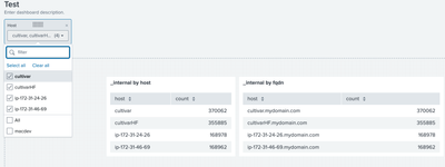

Okay @rwheeloc I think I might have something which will work for you. Its currently based on hosts in _internal but you will hopefully work out whats going on...
There is a table off-screen with a search which generates the list of hosts with the domain added:
You can then use this in your search as
| search host IN ($calcTokens:result.fqdn$)
Below is the full Dashboard Studio definition for you to have a play around with, hopefully this can be adapted for what you need. You can make that calcTokens search do anything such as a lookup of case statement to determine the index etc of a particular value.

rwheeloc
Thank you very much! I think I've got it working as intended now!
