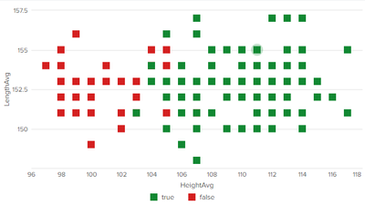

Hello everyone.
I want to add line as division line on the scatter chart.
I'd like to know which values are in specific area that's why I want to make the division line on the scatter chart.
If someone knows that, could you tell me how to add these orange lines.
And If I can add these orange lines, Can I set the position ?
As you can see the screenshot, there are 4 orange lines.
2 lines are on 8 and 11.7 of X-axis , other 2 lines are on 0.6 and 1 of Y-axis.
niketn
Legend
Hi @jenny_life I have extended my answer based on the Horizontal and Vertical Lines that you need.
PS: I have added Text-Boxes which accept Top position for Horizontal Lines and Left position for Vertical Lines (others I think should be fixed provided Chart is occupying 100% row size, if not you can add more text box settings, or else actual coordinate setting as per your need on similar lines).
The Text Box token is applied to HTML panel with CSS Style to override the same on the chart. There is also a check box added to show/hide these settings which will be defaulted on Dashboard load. Please try out and confirm!
Following is run anywhere Simple XML Code for attached screenshot:

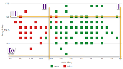

RogerHyde
New Member
Instead of making the positions for the lines fixed, I want to include lower and upper bounds for the average height and length based on a fourth, fifth, sixth and seventh column. Therefore i want to use tokens to set these values based on the outcome of the search.
For example what I have now is the following including three columns:
| table ResultHL HeightAvg LengthAvg
What I want is the following:
| table ResultHL HeightAvg LengthAvg LowLength UppLength LowHeight UppHeight
Where LowLength UppLength LowHeight UppHeight are indicated by IV, III, II and I, respectively, in the last figure. The yellow lines should be based upon the result of the search and put into tokens. Many thanks in advance! Happy Splunking!

jenny_life
Thank you . it works well.
