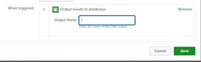

Andre_
Communicator
I found some more information, when I go:
Apps -> DBX -> search -> save as alert -> I get the Output Name field
but if I go:
Apps -> other app (like Search & Reporting) -> search -> save as alert -> I don't get the Output Name field

Did you create database outputs first? The alert action does not prompt for parameters because it uses the mapping and connection you set up in the DB Connect app’s Outputs.
#https://help.splunk.com/en/splunk-cloud-platform/connect-relational-databases/deploy-and-use-splunk-...
If you want to test it manually, use | dbxoutput output="output_to_test_table" in your SPL

@Andre_
I can see option to enter Output Name with DbConenct version 4. There might be bug/ui issue with your particular 3.x version, not sure.
Also i saw an option by directly editing savedsearches.conf, which i haven't tested. You can try this if you can't upgrade to 4.
After saving your alert, add below entry to your .conf with your db output name
action.db_output = 1
action.db_output.param.output = output_to_test_table
