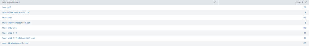

The problem is that not all values ​​are found in splunk. I only see 8 but in the example on regex101 there are 19 different ones.
Here you can see my result:

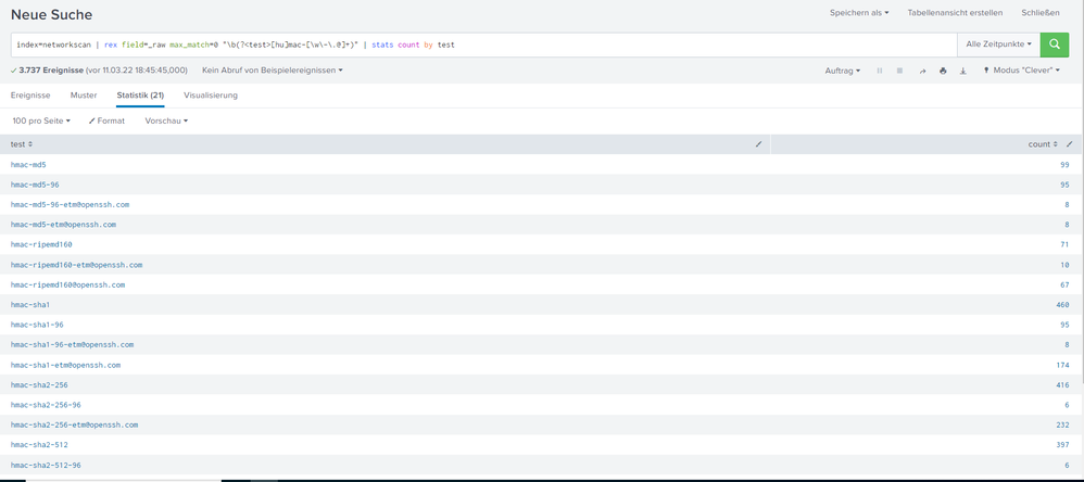

You are right, on my screenshot you see the complete search. With "max_match=0" i get the right results:
If I dont set "max_match=0" then I get exactly the same result as with field extractor:

Yes, some of my events contain all 19 MAC algorithms but not all. Some of these algorithms only occur occasionally in other events.
I try your search and it looks okay:

 You need to post your complete search line; all screenshots only shows the regex portion, but not the complete rex command. (Also, post search line in text; screenshot is not a good way for other people to help.)
ITWhisperer
There is more to the search (you have counts) - can you share your complete search?
bnybln030
Engager
Here is  now a picture from field extration in splunk. It is the same result like my search....
ITWhisperer
These appear to be counts of the occurrence of these algorithms in your events pipeline - perhaps only these 8 are present?
