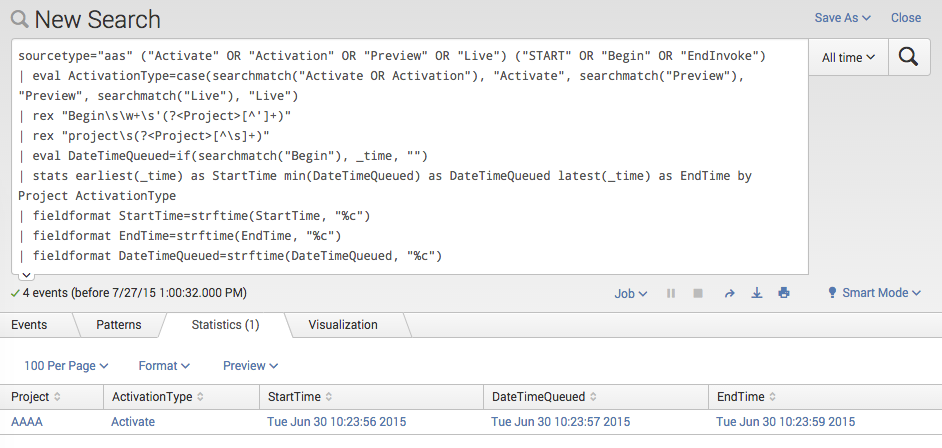

The following search string appears to generate what you want.
sourcetype="aas" ("Activate" OR "Activation" OR "Preview" OR "Live") ("START" OR "Begin" OR "EndInvoke")
| eval ActivationType=case(searchmatch("Activate OR Activation"), "Activate", searchmatch("Preview"), "Preview", searchmatch("Live"), "Live")
| rex "Begin\s\w+\s'(?<Project>[^']+)"
| rex "project\s(?<Project>[^\s]+)"
| eval DateTimeQueued=if(searchmatch("Begin"), _time, "")
| stats earliest(_time) as StartTime min(DateTimeQueued) as DateTimeQueued latest(_time) as EndTime by Project ActivationType
| fieldformat StartTime=strftime(StartTime, "%c")
| fieldformat EndTime=strftime(EndTime, "%c")
| fieldformat DateTimeQueued=strftime(DateTimeQueued, "%c")
Approach is to ignore transactions, and instead identify the specific events we care about, and classify them with fields. Then we can just use stats on those fields to group things up. This assumes that Project is a unique identifier and only shows up once for each step.
Recommend building that search pipe by pipe to see how it progresses.
screenshot
Laya123
Communicator
Thank you so much its working
