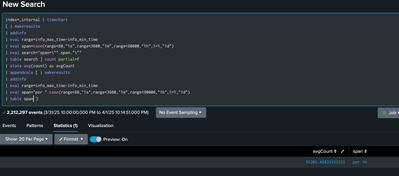

@tkwaller1 if you want to get a single value out of it then you could do something like the below - Ive added an appendcols to add the span info into a field so people know what its an average of.
index=_internal
| timechart
    [| makeresults
    | addinfo
    | eval range=info_max_time-info_min_time
    | eval span=case(range<60,"1s",range<3600,"1m",range<90000,"1h",1=1,"1d")
    | eval search="span=\"".span."\""
    | table search ] count partial=f
| stats avg(count) as avgCount
| appendcols
    [| makeresults
    | addinfo
    | eval span="per ".case(range<60,"1s",range<3600,"1m",range<90000,"1h",1=1,"1d")
    | table span ]
