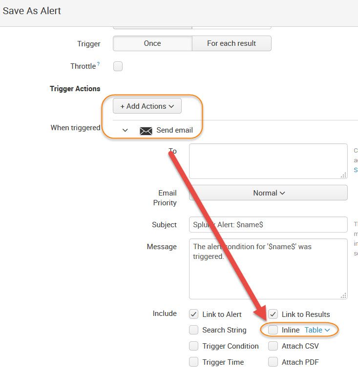

Richfez
When you save or edit a search in recent versions of Splunk you are given an option to include the results. You add an action to send an email then put a checkmark beside the "Include" item "Inline". I can't remember, but I think this is in Splunk 6.3 and above. What version are you on?
Screen shot of including results in alert
Richfez
somesoni2
Revered Legend
It's available in all Splunk versions.
larryleeroberts
Yes, I do get that and have played around with it today. It is true that it does pass the information. It would be nice though if I could actually assigned the entry to a field.
The main problem here is that if your trying to forward these events to say another monitoring product, you need to be able to map the fields. So for example, if I want to forward an Alert to something like Netcool OMNIbus, I need to be able to map it to fields. OMNIbus has tons of ways to receive events including an email probe but even that is an issue when it comes to Splunk. In order for that to even work, I would need total control over the email body and subject line that are sent. When setting up an Alert Action in Splunk, they do not appear to offer this option. I LOVE Splunk so far but not thrilled with the abilities to send data out.

somesoni2
Revered Legend
I just realized that you're looking to include the search result in Email Alert (the argument list that you provided is for Alert script and confused me). See @rich7177's answer for standard way of including results inline OR as attachment. You can also see this link to see what all other attributes (tokens) are available for use in the email alert
