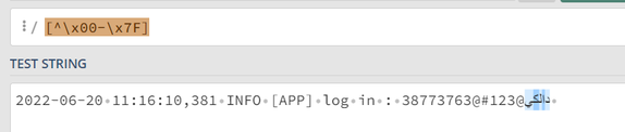

VatsalJagani
@indeed_2000 - The regex does work in the event that you provided.
https://regex101.com/r/sG3IdX/1
