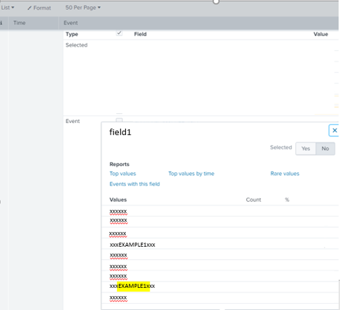

xploresplunk
New Member
I've added a picture and I highlighted the word that I'm trying to get the time of (In that case, the earliest)
