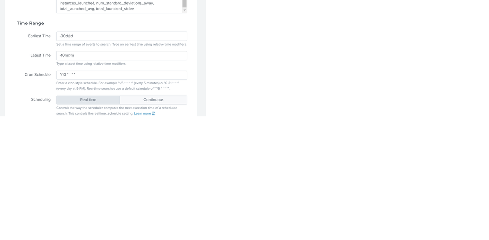

But this is the problem, i have an option to configure cron schedule even for real time search. I attached a picture now, so you can see it.

Which version of Splunk are you on ?
The point is not that whether you are getting the option from GUI or not. Even if one is not getting it, I guess it can even then be given from the conf directly.
It is about the essence of it. In real time, your rolling window period keeps on adjusting the new search time window which means that at real time you are getting the coverage as per your defined criteria.
Still setting the cron job would keep on filling your dispatch and hit the performance and you will have to set a pretty low job expiration time because you would not want too many RT searches running Live on your system when all those jobs would be returning you with the same alert result.
If the cron time has to be filled - You must give it a 24 hour cron, as the default expiration time of searches in dispatch is 24 hours (if you have not changed it to something else). So basically at the run time of every new search you would expire your previous one.
