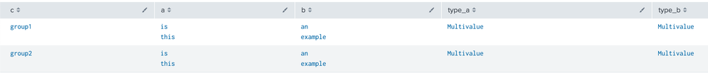

As mentioned, I wanted to flatten a series of multivalue fields, and make it just like single row entries, where the type will become "String" and not "Multivalue". To be clearer, here's my base search:
| makeresults
| eval a="this,is"
| eval b="an,example"
| eval c="group1,group2"
| makemv delim="," a
| makemv delim="," b
| makemv delim="," c
| stats values(a) as a, values(b) as b by c
| eval type_a=typeof(a)
| eval type_b=typeof(b)
result of this will be:
so what I wanted to do is make the result like this:
