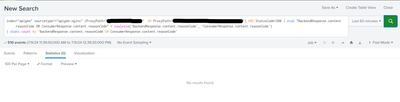

@yuanliu this is the query which I am using to filter the data
index="apigee" (ProxyPath="/xyz" OR ProxyPath="/abc") AND StatusCode=200 | eval "BackendResponse.content.reasonCode OR ConsumerResponse.content.reasonCode" = coalesce(BackendResponse.content.reasonCode, ConsumerResponse.content.reasonCode) | stats count by "BackendResponse.content.reasonCode OR ConsumerResponse.content.reasonCode" StatusCode
It is showing the event count, but it is not generating the results. Highlited the same.

@ITWhispererthanks for being patient with me. I have copied the same query which you have mentioned and this is the result
index="apigee" sourcetype!="apigee:nginx" (ProxyPath="/xyz" OR ProxyPath="/abc") AND StatusCode=200 | eval "BackendResponse.content.reasonCode OR ConsumerResponse.content.reasonCode" = coalesce('BackendResponse.content.reasonCode', 'ConsumerResponse.content.reasonCode')
| stats count by 'BackendResponse.content.reasonCode OR ConsumerResponse.content.reasonCode'
ITWhisperer
OK try it with double quotes on the stats command (which is counter-intuitive!)
index="apigee" (ProxyPath="/xyz" OR ProxyPath="/abc") AND StatusCode=200 | eval "BackendResponse.content.reasonCode OR ConsumerResponse.content.reasonCode" = coalesce('BackendResponse.content.reasonCode', 'ConsumerResponse.content.reasonCode') | stats count by "BackendResponse.content.reasonCode OR ConsumerResponse.content.reasonCode"
sridharadurthi
Engager
Finally it is working now 🙂 Thank you so much. You made my day.
