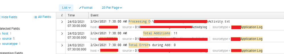

Hi, I want to create a new field which will simply pull out the first x number of characters from a line on an event log. I am not sure of the regex to use as I assume that's the option to go for?
As per the image this log brings back an initial datetime stamp followed by certain text (which is what I am searching on). If I can get this in a specific field it will help for amending my query, it's output and the linked alert which uses this.

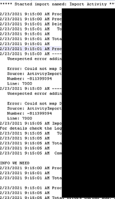

Apologies, here is the image. The text displayed i.e. the lines with the datetime stamp and then text isn't a field so how can I create this as a field, the first x characters.

This is the original log file, each line is a new event. I am using an OR statement to pick up on particular lines.
There's no pattern hence I think the best solution to have each line captured in a new field is to use the first x amount of characters, maybe 50.
Let me know if that makes sense.

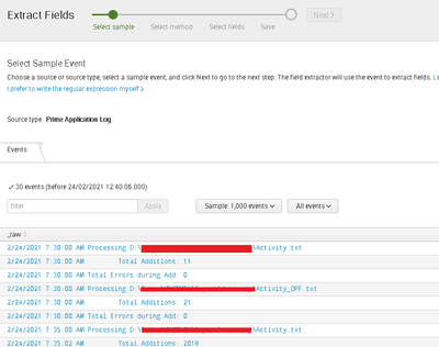

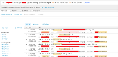

Apologies if not explaining well (newbie). Do the attached images help in regards to the Splunk query and the log in it's original format.
The lines which start with a datetime stamp aren't a field I can reference by name - or am I wrong?
I want to create this as a field, there's no pattern hence my suggestion of first x characters.
