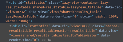

Everyone,
I am trying to edit the ID values for the "div" tags mentioned in the above screenshot so that they are unique i.e the first one would be id="statistics" and the second id would be id="statistics_1" etc.
I am getting the code above when I inspect a table panel in Splunk but not aware of how this can be edited.
Can you suggest how this change is possible?

Option 1. Go by data-cid which will be unique. This should be easiest thing to try. You can find this attribute even in the screenshot you have provided for div with data-view="views/shared/results_table/ResultsTableMaster". So you need to pull div#statistics[data-view="views/shared/results_table/ResultsTableMaster"][data-cid] which is unique.
Option 2. Nested selector means in your case try with #element1 div#statistics[data-view="views/shared/results_table/ResultsTableMaster"], #element2 div#statistics[data-view="views/shared/results_table/ResultsTableMaster"]  etc. which will be unique. Chrome Browser inspector does something similar. This would require change in your accessibility checker.
Option 3. Simple XML JS Extension requires an iterator to identify div#statistics[data-view="views/shared/results_table/ResultsTableMaster"] nodes in the dashboard and for each node suffix and incremental id to existing i.e. statistics becomes statistics1, statistics2, statistics3 through jQuery code. I feel this is purely jQuery question which you should be able to figure out through google search if you do not have jQuery background.
Following is a JS example which does this 5 seconds after dashboard loads. You can change to a different event based on your need (like click of a button, or completion of most expensive query on Dashboard etc). Currently it just adds incremental IDs similar to how Splunk adds element1, element2 etc. You can change as per your need. I have added alert() and console.log() for debugging purpose. You can remove after test.

The use case for the above change is to meet the WCAG accessibility standard of having Unique Element Id’s in the Splunk Dashboard Page.
Its only when I edit the id’s mentioned in the screenshot (using Chrome Dev Tools )that the issue is going away but this is just temporary.
I was able to add Id’s to panels like “panel id=“panel_1” etc but that doesn’t seem to solve this problem as all Statistics related tables in the page have the same id of statistics assigned to them. (Some base file is assigning this value to all of them but which one ? )
I would want to know where this edit needs to be made permanently? I don’t have backend access ( we are on Splunk Cloud ) but I would like to know suggestions of how this can resolved.

When an accessibility checker scans the page it is marking these ids as errors for not being unique. So like I mentioned earlier it needs to be updated somehow.
Option 1:  How to use nested id's?
Option 2: If possible can you help me out with the JS code for this? A sample code could be helpful and I could use that as a reference to update any other id's. To replicate this, just make a sample table in Splunk --> Inspect using Chrome Dev Tools --> You should be able to notice the duplicate id's.
Since there could be more than one table on the page, a sample JS code covering this aspect would be an added benefit.
