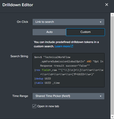

Hi there,
I am trying to enable drilldown on a dashboard view to use a custom search(see below search string snippet). Although the search with the aforementioned string works fine on its own but its complaining when I use it within the drilldown custom search saying "Unbalanced quotes". Any idea why ? Thanks.

You have some non-encoded parts of the query in that URL - not sure how they are there, but for example
<link target="_blank">search?q=$env$%20%22TechnicalWorkFlow.spkFormSubmissionGlobalOptIn%22%20AND%20%22Opt%20In%20Response%20%3Cresult%20success=%5C%22false%5C%22%22%0A%7Crex%20field=_raw%20%22%5E%5B%5E%5C%5D%5Cn%5D*%5C%5D%5Cs+%5Cw+%5Cs+%5Cw+%5Cs+%5Cd+%5Cs+%5Cw+%5Cs+(?P%3CUUID%3E%5Cw+)%22%0A%7Cdedup%20UUID%0A%7Ctable%20UUID%20_time&amp;earliest=$field1.earliest$&amp;latest=$field1.latest$</link>
Those contain the following characters that are not encoded (=+?)
The line should be
          <link target="_blank">search?q=$env$%20%22TechnicalWorkFlow.spkFormSubmissionGlobalOptIn%22%20AND%20%22Opt%20In%20Response%20%3Cresult%20success%3D%5C%22false%5C%22%22%0A%7Crex%20field%3D_raw%20%22%5E%5B%5E%5C%5D%5Cn%5D*%5C%5D%5Cs%2B%5Cw%2B%5Cs%2B%5Cw%2B%5Cs%2B%5Cd%2B%5Cs%2B%5Cw%2B%5Cs%2B(%3FP%3CUUID%3E%5Cw%2B)%22%0A%7Cdedup%20UUID%0A%7Ctable%20UUID%20_time&amp;earliest=$field1.earliest$&amp;latest=$field1.latest$</link>
Note the encoding of = (%3D), + (%2B) and ? (%3F)

<drilldown>
</drilldown>
The line should be
Trex1
@bowesmana Thanks heaps, that worked like a charm! However keen to know if you used a particular tool for the encoding as it appears each time I modify the custom search string in the drilldown option, it messes up the encoding ??
