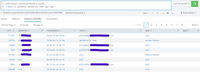

The base index of assets is:
index=asset sourcetype=Network:Asset
| table id ipAddress macAddress name type tags

I'm trying to merge the data together with the asset information so I know what and where the activity is.  I'd like a table like this:
id ipAddress name description lastSeen score type macAddress tags
I could join the indexes to get what I'm looking for using device ids as you suggested.  But the issue I'm having is the second SPL with the list of ids in the device_ids field.  I don't know how to enumerate them to merge the asset index with the test index.
