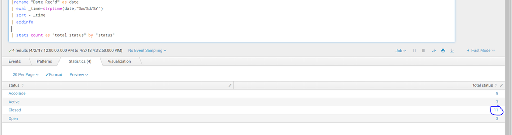

@elliotproebstel this i what i am currently seeing and i am running both all time. Count is OFF

I'd recommend running both searches without the stats command at the end and comparing the results to see if you can identify the two events that are getting filtered out in the search using the time filters. Can you post them here (redacting sensitive info, if needed), along with some that are not getting filtered out? Maybe we can find the pattern of why they're being treated differently. I suspect the date field isn't formatted exactly the same on all events. My gut instinct is that maybe the two events that are getting trashed have a date with a single digit day of the month, because %d will match only if the day is two digits (requiring a leading 0 if the day is 01-09).

@elliotproebstel, the plan here is to be able to run a search based on time from .csv. If I run the search without | where ... I get an accurate count of field values from the csv but when I add the |where .... I’m getting a -1 or -2 On the total count .. hope this helps clarify

please see images below @elliotproebstel
