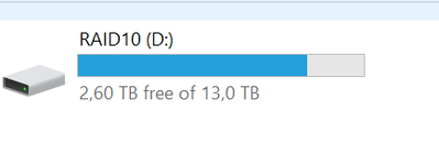

Thanks for your answer, however, we are facing an issue where there is enough space in our index but our disk space has reached around 80%. SO I just want to know if volume trimming happens on the disk level as well ? Below attached are our index configuration for paloalto index and the disk status.
[firewall_paloalto]
coldPath = volume:cold\firewall_paloalto\colddb
homePath = volume:hotwarm\firewall_paloalto\db
thawedPath = D:\splunk_data\firewall_paloalto\thaweddb
tstatsHomePath = volume:hotwarm\firewall_paloalto\datamodel_summary
frozenTimePeriodInSecs = 47304000
maxTotalDataSizeMB = 4294967295

Siddharthnegi
Contributor
[firewall_paloalto]
