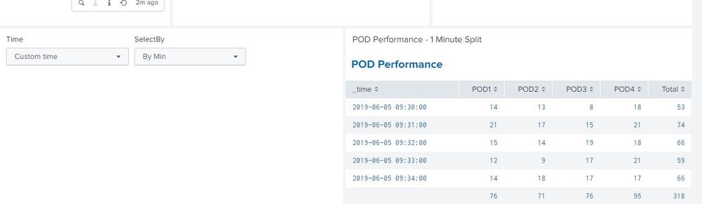

These are three Panels in that row ( Drop down panel, 1st Panel and 2nd Panel ), below is the XML. If i move the drop down code just above the code of the other two panels, the drop down panel disappears :

@niketnilay This approached worked fantastic for me. Only challenge i am facing with this one is the Placement of the Drop down above the hidden panel, Please see the screenshot. Is there any way i can add the Drop downs always above the panel which is visible and not hidden.

@macadminrohit that should be staright forward Simple XML change unless I got the question wrong.
Create a separate row for inputs before the panels that are to be displayed based on selection of input.
