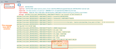

hello all,
My problem is I thing Splunk have max character accepted for stats command,
when i perform this search
index="bnc_6261_pr_log_conf"  logStreamName="*b6b3-f8d14815eaf8/i-09bfc06d1ff10cb79/config_Ec2_CECIO_Linux/stdout"
I see 3 event, and now if I perform this request

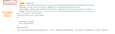

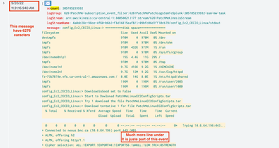

index="bnc_6261_pr_log_conf"  logStreamName="*b6b3-f8d14815eaf8/i-09bfc06d1ff10cb79/config_Ec2_CECIO_Linux/stdout" | eval l = len(message) | stats values(l) as NumberOfCar
I received two len, one was lose
172
6277
if I perform this statistic request :
index="bnc_6261_pr_log_conf" | logStreamName="*b6b3-f8d14815eaf8/i-09bfc06d1ff10cb79/config_Ec2_CECIO_Linux/stdout" | eval length=len(_raw) | stats max(length) perc95(length) max(linecount) perc95(linecount)
recived:
Max(Length):29886
perc95(Length):275756
The event I lose have effectively 28973 character,  I thing the actual limit is 10 000.... I already change TRUNCATE parameter at 80 000. It for that I can load event with up to 10 000 character....
My question is, Can I change the stats  limit in splunk for the max characters ? with which parameter ? and where from the web page ? can be change by non admin  and for a  specific source ?
Thank for your future help.
Hugues

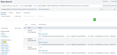

Thanks for your reply, Sorry im a newbie , I try give you much detail possible...
I try give you more information. When I try this request,
Output of 3 event with different message content and lenght:

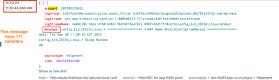

Event 11:31:51/
Event 11:31:16:
Event 11:30:46/
If I count of length of each message, I have only two length in the output, The biggest message count are not there. All message are different , time is different and all 3 have the same logstream name.
I create this small exemple  for try to explain my problem. I have same problem with a more complexe request.

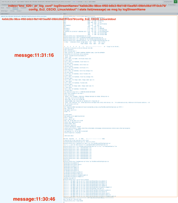

>index="bnc_6261_pr_log_conf" logStreamName="c36be289-86f8-4406-94ea-6933b26f9767/i-0ee87265c1f2f4fb7/PatchLinux/stdout" | stats list(message) as msg by logStreamName
my list msg for each logstram name lose the biggest message when is bigger of some number of caracters, may be 10 000.

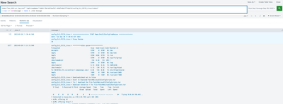

The screenshots show odd behavior.  Please run this query to see what Splunk is setting message lengths to.
| table l message

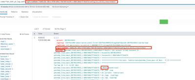

All 3 messages have the field message, Check the screenshot I made ...
and I lose the message 11:31:51...
see screenshot
when I perform this request or other type of request with eval on field message , I lose event 11:31:51 in the list msg, only 2 msg appear in List msg.

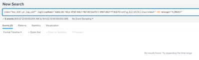

if I try easy request index="bnc_6261_pr_log_conf" logStreamName="4a0dc28c-98ce-4f60-b6b3-f8d14815eaf8/i-09bfc06d1ff10cb79/config_Ec2_CECIO_Linux/stdout" AND message="*LONGOS*" , this suppose get out only the message 11:31:51, I get nothing ...
The Event:
output of my search on logStreamName="4a0dc28c-98ce-4f60-b6b3-f8d14815eaf8/i-09bfc06d1ff10cb79/config_Ec2_CECIO_Linux/stdout" AND message="*LONGOS*"

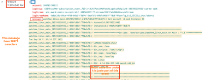

only two event output
not see the event for 11:31:56 with 28973 characters
I have many other exemple with this problem.... It is not the only case.... every time I have a message with more 6000 characters, may be 10 000 , it disapear when I use stats , eval and table command....
thanks for your help. I am a newbie in splunk , your help is precious!
