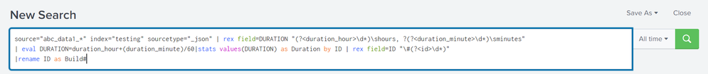

I have another search for different requirement. The search is as follows2021-08-02_14h24_53.png
But for the above query even the first line didn't generate anything.2021-08-02_14h34_23.png
Not sure i'm doing it properly or not.
