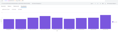

| rex mode=sed field=URI "s/(?<root>\/\w+\/)[^\/]+(?<api>.*)/\1*\2/g"
| stats avg(duration) as avg_time by URI
Harish429
Loves-to-Learn Lots
Thank you for the response.
But this gives me all the API's average response time.
If i just need the resposnse of the api which mich only /api/*/Book ,/api/*/collections/,/api/*/notes then what would be the rex statement

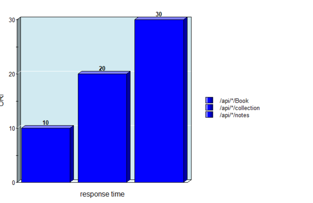

May be i guess i have not communicated Clearly.
the final output should have only three API
ITWhisperer
Correct, but it clearer now; thank you.

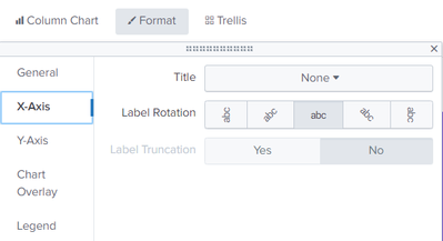

Try it this way
| eval responseTime="response time"
| chart avg(duration) as avg_time by responseTime URI
You can set the x-axis Title to "None"
