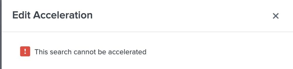

Splunk says "This search cannot be accelerated" when I go to enable acceleration for the report and hit save,

Im afraid this is not the the case. I have admin role and I have enabled acceleration for other reports before. Please also note that the error is "*This search* can not be accelerated" as mentioned in above replies.

I used splunk web interface, went to reports > edit acceleration for the specific report > clicked save and it says "This search cannot be accelerated". Please find screenshot in the other reply.
