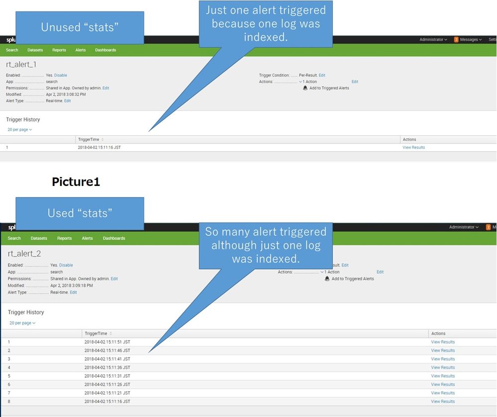

I created a real-time alert in my environment, but it does not work as I expected.
As a phenomenon, alerts are triggered in large quantities even though there is only one log to be detected for some reason.
After examining, the existence of the stats command seemed to cause this phenomenon.
So I created the following alerts 1 and 2.
Alert type : Real-time
Trigger alert when : Per-Result
Throttle : false
SPL : index="rt_alert_test" | table tbyte rbyte
Throttle : false
SPL : index="rt_alert_test" | stats max(tbyte) as max_tbyte | table max_tbyte
And I indexed a log like below.
2018/4/2 15:11:00 tbyte=10000 rbyte=10000
Then a large number of alerts were triggered in alert 2 at intervals of seconds, as with Picture 1.
I found this phenomenon in ver 6.6.6 and 7.0.1.
Is this specification? And I should not use stats in rt-alert?

logloganathan
Motivator
Could you please refer this document
it will explain with simple tabular column
http://docs.splunk.com/Documentation/Splunk/7.0.2/Alert/AlertTypesOverview
yutaka1005
Builder
Thank you for answer!
I understood like below, is this correct?
A real-time alert searches for a captured log and triggers an alert, so one alert is given for one log.
However, since rolling-window-alert invokes alert-action according to the number of events that meet the conditions within rolling-window, alert-action continues to be invoked as long as the number of events exceed the specified range within rolling-window.
The difference in this specification creates differences like the questions I did.
Also do you know differences of move between real-time alert using stats and not using stats?
logloganathan
Motivator
stats give the result in numbers.
in your first question: even for zero log, stats producing the result as no threshold present. it would take zero as value
in your second question:
1)it gave the events for 60 seconds
2) when using stats, it gave number for 60 seconds
let us know if still any clarification you need
