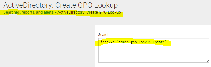

jkat54
Go to settings -> searches, reports, and alerts -> find the search -> click on its name -> modify it -> click save.

jkat54
Ok but you asked "Ability to add to search without re-running entire search?... I've been asked if there is a way to add/extend a search without re-running it in it's entirety. "

@jkat54 - I think you misunderstood. @a212830 was looking for a way to essentially play with cached results. In other words, consider a long running search that you're creating, then you want to add one tweak to it and you're left with rerunning the entire thing which could take so long that it's impractical. Instead, you can run a base search and then manipulate it's results in various ways without re-pulling the raw data from the indexers. I hope that clarifies why the other answer was accepted. Two different interpretations to the question.
