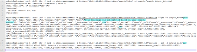

venkatasri
Hi @thaghost99  PIPE are usually fine, the same SPL that you use in UI can be used in API, expect explicit search command at the beginning of the query. which PIPE you are referring to?
venkatasri
Hi @thaghost99
The one you got is not an error 'messages' is an additional information that's being returned by API in outputode=json you can safely ignore it for your case. In this case Your search did not return any results, see the results[] is empty.
To test this further you can set outputmode=raw and execute you won't get any output. Docs not covered how to get rid of these 'messages' in JSON mode.
If the search returns results you see the output as described here - Search endpoint descriptions - Splunk Documentation
An upvote would be appreciated if it helps!

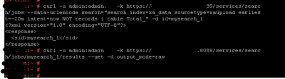

thaghost99
this works....
curl -u admin:admin -k https://xxxx:8089/services/search/jobs --data-urlencode search="search index=xa_data sourcetype=xaupload earliest=-20m latest=now NOT records"
this does not.
curl -u admin:admin -k https://xxx:8089/services/searc h/jobs -d search="search index=xa_data sourcetype=xaupload earliest=-20m latest= now NOT records | table Total_"
NOTE: the Total_ is a valid field. and it works when doing it directly in the web splunk.
venkatasri
Hi @thaghost99
As i initially mentioned, the message only appears in json mode regardless PIPE. output_mode=raw/csv never returns such message. See below.
WITH PIPE, message appears.
WITHOUT PIPE, message appears.
thaghost99
@venkatasri
this works....
this does not.
thaghost99
@venkatasri
i wish it works. but its empty results.
curl -u admin:admin -k https://xxxx:8089/services/search/jobs/mysearch_1/results --get -d output_mode=raw
should i log a ticket that it dont work?
