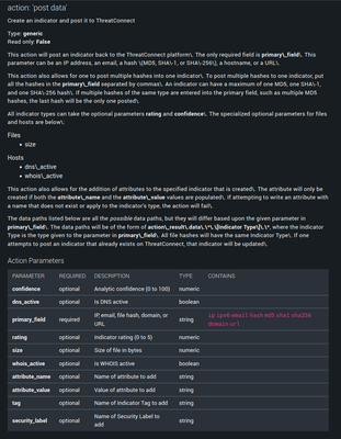

We are trying to use the SOAR ThreatConnect App to send Intel (Domains, URLS) to ThreatConnect via a playbook.
From the documentation, there is a function called POST DATA, which allows us to send the data to ThreatConnect.
Right now if I send a piece of intel, it gets added in under the API key account. But I need to be able to change the Owner. I can do this in a python script easily, but can't figure it out in this App.
The documentation has "attribute_name" and "attribute_value" - which i've tried setting to "owner" and the required owner respectively. But this doesn't work - the app tells me it cannot find the attribute "owner".
The documentation is very lacking here. I can't seem to figure it out.
Any ideas on how I achieve this?

error message:
Indicator created/updated, but failed to update the attribute specified. Please ensure the attribute_name is valid, is applicable to the indicator type and attribute_value is valid
I've tried several: "Owner, owner, owner_name, ownerName, etc. etc."

@CS_ If you are doing so in a script right now then I think your best and quickest option is to update the app?
I assume you already know the required endpoint(s) and data to perform the required update so you should be able to "stitch" it into the existing app?
Hope this helps!

@phanTomgood to see you still kicking about the Forums! 🙂
Pretty much did what you recommended. I spent a few days figuring out how the app works (Spoiler: Whoever coded it hates other people).
Built a custom version of the app which can now do all that i need and more. Plus side; it was good to flex the app building muscles and keep them in shape lol
