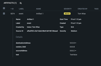

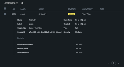

phanTom

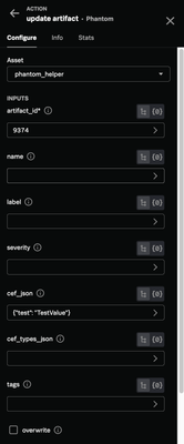

@scorsatto @Dave_Burns I am not sure what version you may be on but the update_artifact action on the Phantom Phantom app does update and doesn't overwrite, unless you tick the box.
I simply put the JSON of the field I wanted to update in the 'cef_json' field and it updated and didn't overwrite.
Bear in mind if you are trying to add the same CEF field to an existing artifact, it won't work as you would need a new artifact. If you use update artifact to ADD the same field with a different value, then it will overwrite due to the above.
