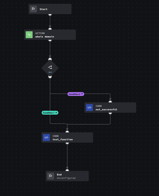

If i create a test playbook, like attached, it seems to work fine.  It's only affecting my existing playbooks.

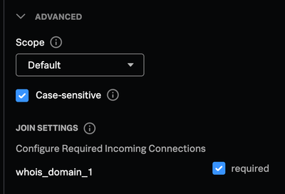

You CAN update these settings by selected the Advanced drop-down in the block settings:
In here you can view & select which blocks need to have completed before the function runs. I would recommend taking a look and seeing if there are any items here that may not run under certain conditions and then you may find why it's failing.
On your example there will likely only be one required app in the join (whois_domain) as it doesn't create them for custom functions.
To answer your original question, if you untick all the boxes in the join settings then the function will still be called but won't enforce anything, BUT it may cause the playbook to run differently than expected unless it's simple enough to not need that awareness of upstream actions.

Once again you've saved me a lot of grief. You are 100% correct.
So I had an action in my decision tree (for the else) which wasn't being run, but was still required on the "join_*" function. I removed the tick for required, and now it's working as expected.
Can't believe I haven't come across this issue before, but happy to know it's just a simple setting to change to resolve it.
