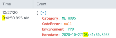

With the time change, my logs are shifted by one hour (logs from an HEC input) :
It is the same case on many logs from several sources.
Like logs from Azure add-on (the props is correctly set with a TIME_PREFIX on the field Horodate)
And same case from other add-on...
How can I fix this ?
Thank you!

Actually, I have this issue on many logs.
What is the TIME_FORMAT setting in props.conf?
Example of props.conf for the two pictures below :
[sourcetype_picture1]
SHOULD_LINEMERGE = false
LINE_BREAKER = ([\r\n]+)
TRUNCATE = 999999
TIME_PREFIX = \"\@timestamp\"\:
[sourcetype_picture2]
SHOULD_LINEMERGE = 0
category = Splunk App Add-on Builder
pulldown_type = 1
INDEXED_EXTRACTIONS = json
TIME_PREFIX = Horodate
This both example worked good until the schedule change on Sunday.
Is the system clock correct?
Actually I did not find a TZ by default for the system.
This TZ parameter is set on some apps like add-on splunk but sometime it is UTC and sometime it is GMT .
What time zone does the system use?
