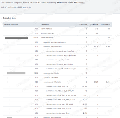

If I wait about 5 minutes, I will gradually see some events appear on the page.  I checked the job inspector, I found that command.search.index, dispatch.finalizeRemoteTimeline, and dispatch.fetch.rcp.phase_0 execution cost is high
but these don't help me much.I tried leaving the search head and performing a search on the indexer web ui, but the search was still slow. this means that there is no bottleneck in the search head?

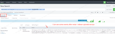

It seems that the indexer server resources are not completely exhausted. So I tried restarting the indexer's splunkd service,Unexpectedly, the search speed seems to have been relieved,When I use the same search query and time range, it is gradually showing the events returned, although the speed does not seem to be particularly fast.
Just as I was celebrating that I had solved the problem, my colleague told me the next day that the search speed seemed to be a little unsatisfactory again, although the search results would be gradually returned during the searching.so, this is not the best solution, it can only temporarily relieve.
