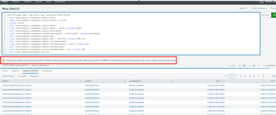

I have the following data.
I am looking to get a line per data, so I can work with it better.
If I use mvexpand I hit memory limits, as I need to do it on all the fields. Is there another way?
Or perhaps I just need to increase the mvexpand memory limits!

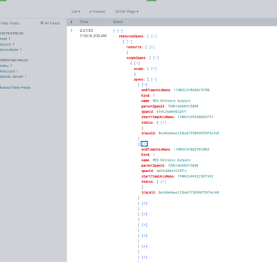

Below is one example of an event I might have (Attached is the RAW data for 4 lines.).
We have multiple Spans in the data. Inside that, we have various attributes.
I want to be able to put in one traceId: = XYZ and get the start and end, name, etc.. of all the Spans that I have.
So I was going to get it in a table format 1 - to - 1 and then when I have that data make tables, graphs, etc..
 I can say that when traceID = XYZ, I will have access to the other data. But as you can see I get an error if the data is too big.
