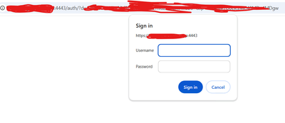

We have Splunk Enterprise installed on a Windows computer which does not have direct access to the internet. To access the internet on that computer, usually we open a browser like Chrome or Edge then enter some required website (example : https:\\www.yahoomail.com) and press enter. Then a pop up will come on the browser which will ask us to enter the credentials. This popup will have our internet proxy server Url with port number that is https://myinternetserver01.mydomain.com:4443 and a option to enter username and password as attached in the screenshot. Once we enter the credentials it will allow us to browse any website on that computer until we log out from that computer. Due to this restrictions, we are unable to use some of the splunk add ons which requires internet connection. We tried many options using proxy settings but none of them are working.
Can some one please guide us where can we input this internet server URL, Port and credentials so that Splunk will have a direct connection to internet and we can use all spunk add on which needs internet.
