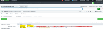

    I managed to retrieve my data in Splunk, except that the tag appears at the start of the log like this; I found a way to remove it via the props.conf file on my TA:
    # (EXTERNE, INTERNE, RIE, CLE)SEDCMD-remove_tag = s/^(EXTERNE|INTERNE|RIE|CLE)\s+//
So, great, the tag has been removed, but the parsing isn’t working for the timestamp.
The _time isn’t being parsed correctly; no matter how I modify props.conf, it doesn’t work. In terms of priority, _time is parsed before SDCMD.

Hello @livehybrid , I tried what you propose but unfortunately, it doesn't work :
That's what I did, on my .conf files :
props.conf :

anissabnk
Yes, of course, I restarted splunk, but it doesn't work.

anissabnk
Hello,
For the sourcetype, that's what I obtain :
[splunk@splunk ~]$ /opt/splunk/bin/splunk btool props list st_postfix --debug
