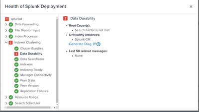

i have a problem in the indexer cluster master
i got error from 1 week ago which is red color saying there is a data durability .

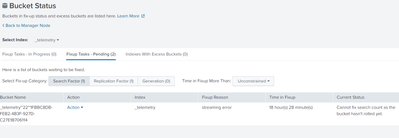

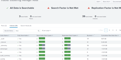

and this photo for indexer clustring from the cluster master
and this from inside 1 index
any help ?
tej57
Contributor
Additionally, you can also try rolling the bucket manually as mentioned in the reason. The SF isn't met because it needs the bucket to be rolled. Click on the Actions drop down and roll the bucket. This should also help you fix the SF/RF not met issue without any downtime.

KhalidAlharthi
@deepakc  will this affect any data cuz it's production env .
deepakc
Builder
Providing there are no issues, a rolling restart is OK to perform. Its best to do this when it's least busy or have maintaince Window for your BAU operations.
A rolling restart performs a phased restart of all peer nodes, so that the indexer cluster as a whole can continue to perform its function during the restart process and data should be sent to the other indexers, whilst one is being restarted. There a number of checks it perfoms so can take a while which depends on your architecture.
First check the status, you can use the manager GUI or CLI
/opt/splunk/bin/splunk show cluster-status --verbose
Restart from the GUI or use the CLI
/opt/splunk/bin/splunk rolling-restart cluster-peers

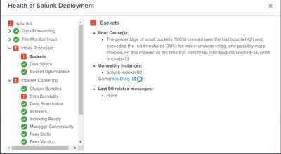

i did a rolling restart and the issue still persist also another issue comes out
deepakc
Builder
Those vmware-vclogs are creating lots small of buckets(folders) - this happens when the data- onboarding has is incorrect - timestamps or formatting, I would look at those logs and ensure you have applied proper data hygine with the correct TA
