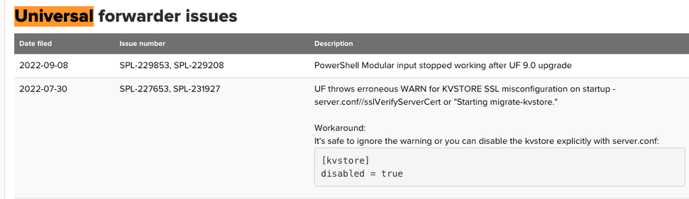

VatsalJagani
@nbommu , @schose - Note that there was a issue like that with Splunk 9.0.0 and 9.0.1 which was fixed in 9.0.2 or 9.0.3.
Release notes - https://docs.splunk.com/Documentation/Splunk/9.0.1/ReleaseNotes/KnownIssues
Please consider upvoting/accepting the answer if this helps!!!

VatsalJagani
@likedasplunk - Have you tried disabling the kvstore from the server.conf on the UF as suggested by @schose ?
likedasplunk
@VatsalJagani
I did try disabling kvstore in server.conf and it did not fix the issue.

schose
Builder
Hi,
Same here.. for some reason the update script tries to upgrade mongo-db on UFW and get stuck. seems like a bug.
disable kvstore in server.conf works for me.

schose
Builder
Hi Niranjan,
Mongo is no component started by UFW but only by Splunk Enterprise.. So this is surely a bug.. it also see to make a difference if you use .tgz or .deb.
I had the issue using .tgz. My workaround is this task:
- name: ensure kvstore is disabled on UFW
  ini_file:
    dest: /opt/splunkforwarder/etc/system/local/server.conf
    section: kvstore
    option: disabled
    value: true
regards,
Andreas
