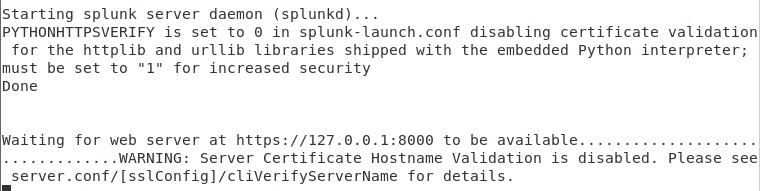

When we attempt to set cliVerifyServerName = true in server.conf and start splunk, the following is message just keeps being echoed  in an endless loop "ERROR: certificate validation: self signed certificate."
We are only using self signed certificates to secure splunkd but SplunkWeb does have a real cert signed by an recognized signing authority.    If we don't set this we see the following message on startup:
".WARNING: Server Certificate Hostname Validation is disabled. Please see server.conf/[sslConfig]/cliVerifyServerName for details"

The feature to use TLS hostname validation for Python modules was available starting in 9.0.  See https://docs.splunk.com/Documentation/Splunk/9.0.4/Installation/AboutupgradingREADTHISFIRST for details.   We were able to silence the message by setting PYTHONHTTPSVERIFY = 1 in splunk-launch.conf.  Hope that helps.

Yes, I can confirm that when I added that to splunk-launch.conf the python message went away.
Thanks for clarifying your issue above yesterday on using two different certs causing the problem.  My issue ended up being a typo in the sslRootCAPath in server.conf.
