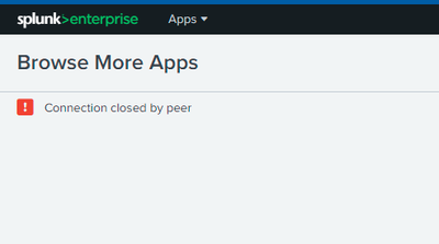

My client wants to have access from the monitor console and HF to update certain apps and so on.
Each time they try to do a connection they get the message:  Application close by the peer
02-13-2022 01:00:01.238 -0500 ERROR ApplicationUpdater [2040833 ApplicationUpdateThread] - Error checking for update, URL=https://apps.splunk.com/api/apps:resolve/checkforupgrade: Connection closed by peer

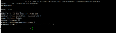

If I ran a curl from the server I got connection established:
So it's not a firewall issue.

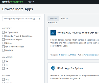

The client wants to be able to see this:
But they are getting this error:
