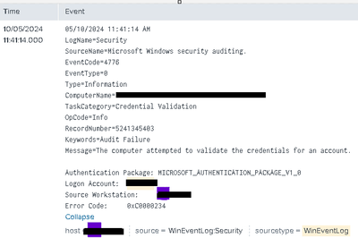

We have a user that is constantly getting account lockout issues.
All our Domain controller security logs etc are extracted into splunk every fifteen minutes. I am attempting to complete a search from the Splunk>enterprise --- New Search field but I can only extract the below information which tells me the user, source, and host and that the user has an Audit failure.
Please could someone point me to how I would go about extracting the information of what machine the user is getting the account lock from. I see quite a few messages on the internet but they never say where the actual message should be input from. Is it directly into the New Search field....

Splunk has been setup to extract the logs and get all the needed information from AD event logs including event ID, User ID, etc, etc in order to troubleshoot any problems in ADDC such as user account lockouts etc.
The image from my previous question is from a search of the users ID and in this case it pulled eventcode 4776, basically saying the account is locked out?
The question is how to I investigate how to get to the root cause and find out what is locking the account out.

In the details of the search in Splunk I can see that there is a logon account which I search on - also a source source workstation at least 3 different ones with the eventcode=4776 and 3 different hosts which are the Domain Controllers of the domain.
I assume the hosts are where the user is attempting to validate credentials. Does this mean that the user is attempting to validate from different workstations and the validation will go to the nearest DC in the Domain.
So I assume the source workstation is where the user is attempting to login from?
