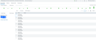

We have recently upgraded to Splunk Enterprise 9.0. When I try to run a search query without adding the index field into it, the event count are showing wrong. Also if I try to see the respective event logs, from Verbose mode they are weird and this is not usual format of logs.
In other case, if index is mentioned in the query, everything is working fine and asusual.
This issue occurs only when the search query have stats or chart commands to visualise the data. Below is the sample search query which I used
host=abc sourcetype=xyz |stats count
I am not sure whether it is a bug in Splunk 9.0 or any other issue from config side (like limitations in search head). Could anyone please help me on this.

Could any help or suggest me on this? Why am I getting blank events in the verbose mode when I run the search query without index field?
akarivaratharaj
Communicator
With the same query, if I try to view the events from verbose mode, I get something like blank events. Please. refer the attached screenshot. But this was not occurring earlier. We used to see the respective log events for the host and sourcetype which are mentioned in the query (though index is not included.)

If the search indexes are based on roles, then the search query should behave in same way with or without any commands (like statistical command, chart commands or any other functions).
In my case, I am getting the empty logs whenever I run any of the below queries
(or)
host=abc sourcetype=xyz |timechart count
whereas, with the below query (without mentioning index) I am able to see the log events successfully.
