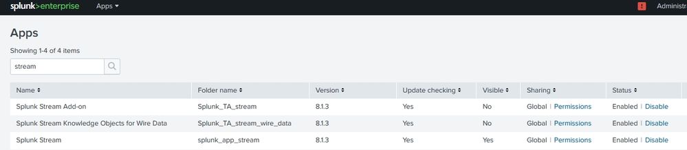

The App and add-on are already installed

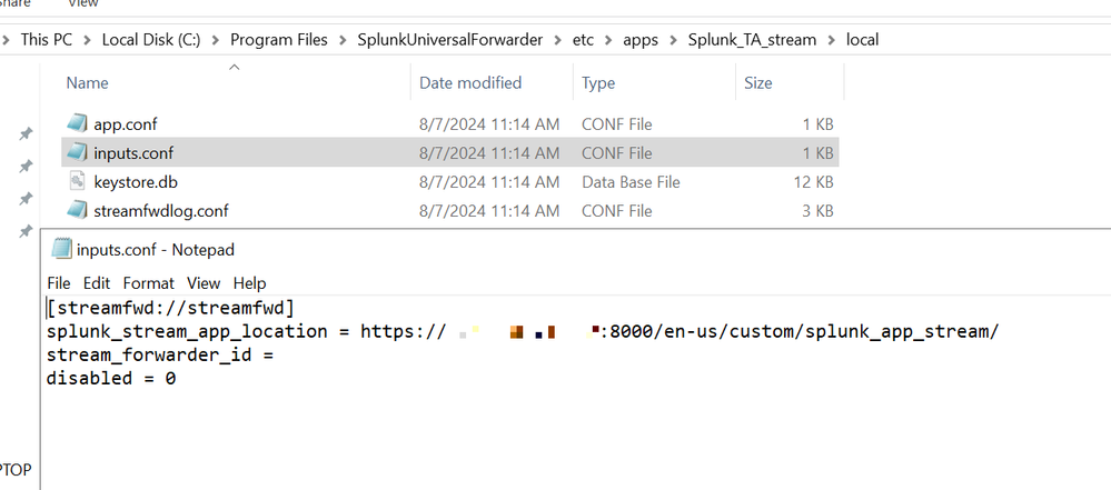

The Splunk_TA_stream has been deployed to the UF:

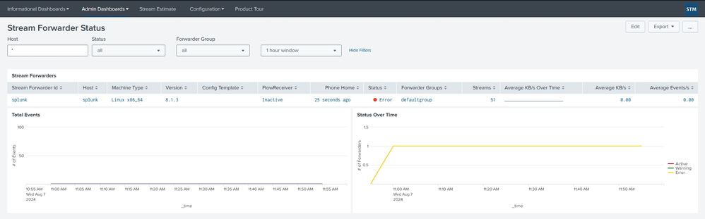

But I found that the streamfwd.exe is not running. Also I don't see the UF in the dashboard:
(only the splunk single instance itself is present, and it is even in Error Status)

Hi @Footoasis0868,
Can you confirm if your Splunk instance GUI access is HTTPS enabled? If not your splunk_stream_app_location setting on UF must be http://xxxxx:8000/en-us/custom/splunk_app_stream/
Regarding your Splunk instance itself error state,  please confirm you run set_permissions.sh to be able to start streamfwd.exe

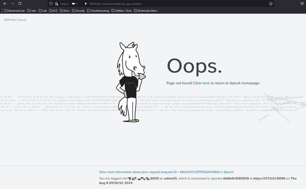

Hi @scelikok ,
Thanks. I checked the URL, and it is an error page and I can't locate the requestid from the splunk internal logs.
Regarding the set_permissions.sh, yes, I have run it using root in my Splunk instance. Just make it clear, I don't need to run similar script on the Windows server where I deployed the Splunk_TA_Stream app, correct?
