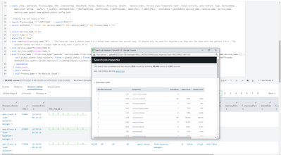

Hi
I have a Splunk panel that takes ~20 seconds to load, but when I click on the inspect it tells me it took .7 seconds to load.
When I pull it out to just SPL it does run fast, it is just the final visualization that seems to take extra time in the Splunk pannel. Is there anything I can do here or a way to monitor this? OR how do I fix the lag?
For information, I am running Splunk 8.1 on one SH with 3 Indexers.
To add once it is loaded it works fine - its just the initial load that is very slow

How are you generating the multivalued filters for services_type and type? Are you using base searches in the dashboard?
robertlynch2020
Influencer
Hi
Yes, I use 2 base search .
One base search for the initial data pull.
Then a second base search to refine the data filters etc.. so we don't have to keep re-running the initial data pull if something is changed.  I have used this before on many dashboards, but this is the first where is it so slow to load.
However, to test this out - I removed all the base searches and put the code directly into the panel and it now works super quickly... This is a bit disappointing as I thought using base search in this structured way was a good way to reduce code replication, but in the end, if I have to put the code into all the panels if I want fast pannels it can become difficult to update a dashboard easily.
Is there any way to get around this?

If you're willing to provide the query of the base searches, i'll be happy to help optimize it.
robertlynch2020
Influencer
Hi
Please note this is very long and complex. So if you don't have a suggestion, don't worry.
We are using metric data.
Below is the 2 base search, then in each pannel I call base search 2 and filter or display what is needed.
The initial saved search is this, this is inside the first basesearch. But it all runs in .7 seconds, it's not the search that is slow. It is when I am trying to display it.
| savedsearch Process_Data_Pull_v12_Report mx_env="dell730srv.fr.murex.com:15022" BPC_VALUE_TOKEN="*"

Wow, you did provide fair warning, there's a lot to unwind here. Just on a high level, the very generous use of multiple append and joins forces the search and processing to occur in a certain sequential order which is likely the cause of the delay.
In particular, the join in your base search 2 would the first I would focus on. When using a join, the subsearch actually runs before the main search. See if this is the issue by deleting the join in your 2nd search and see how it impacts performance.
richgalloway
I suspect most of the time is consumed by the browser building the visualization.  To fix that, consider rewriting the dashboard using Splunk UI (React).
