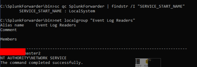

Listing the inputs status give no eventlog listed. After some exploration, the forwarded eventlog is different with windows common eventlog (security, system) that can automated sent to the splunk.
I also try to match the user service that run splunkforwarder with the Event Log Readers permission. And there is no user has the permission. Maybe this one is the reason.

Sorry for late update. Listing the inputs with btool show all the config and it also include the forwarded event stanza. Also when search for Event Log Reader permission i check this one. Am i need to add the user to the Event Log Reader group?
