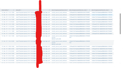

The config tracker was pretty useful as I found the following settings in app.conf file (deployer_push_mode&install_source_local_checksum) have been changed to new value then got reverted to old value and also found "deployer_push_mode=full" then deleted from some SHC members  meanwhile "deployer_push_mode=full" is set on the deployer in app.conf file of the app
