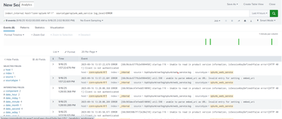

Karthikeya_0-1758031390750.pngKarthikeya_0-1758031390750.pngKarthikeya_1-1758031406189.pngKarthikeya_1-1758031406189.png
Karthikeya
Communicator
this is happening frequently. Sometimes it will load fine sometimes it won't load like now. When I am checking web_service.log, I see these errors
2025-09-16 13:03:58,859 ERROR   [68c960398b7f172e20e210] util:598 - unable to parse embed_uri as URL: Invalid entry for setting : embed_uri
2025-09-16 13:03:58,859 INFO    [68c960398b7f172e20e210] root:355 - Proxied mode ip_address=127.0.0.1 port=8065 exposed_port=8443:
2025-09-16 13:03:58,963 INFO    [68c960398b7f172e20e210] root:619 - overriding JSON MIME type with 'text/plain; charset=UTF-8'
2025-09-16 13:03:58,971 ERROR   [68c960398b7f172e20e210] startup:116 - Unable to read in product version information; isSessionKeyDefined=False error=[HTTP 401] Client is not authenticated
